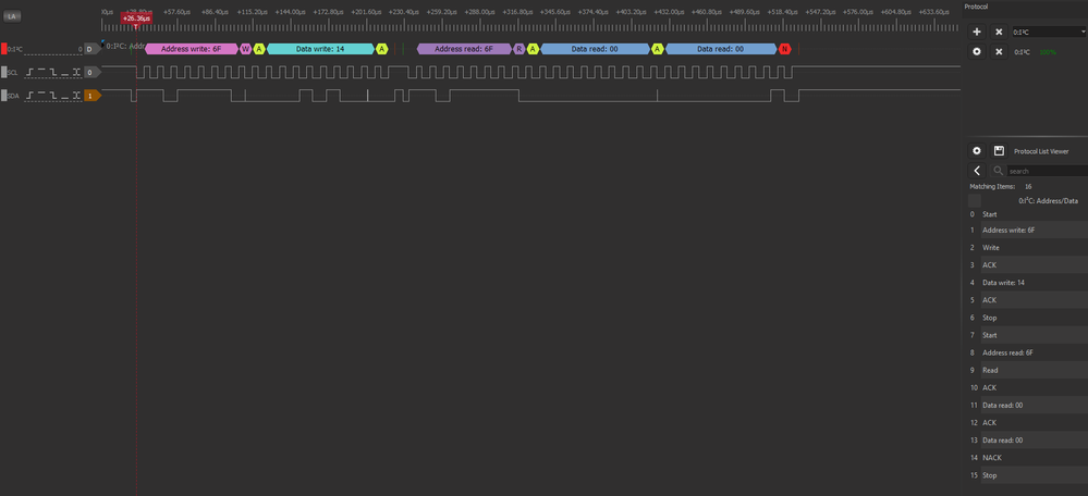

Now I have problem with reading.
I have got 1 stop bit more.

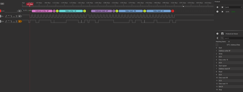

Here is good communication packet.
I receive:
   S-Address-W-A-Command-A-
P
-S-Address-R-A-Data-nA-P

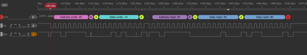

In position 6 I have stop bit. It is wrong.
Any idea, what is wrong?

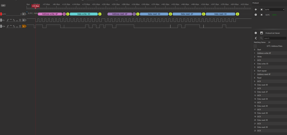

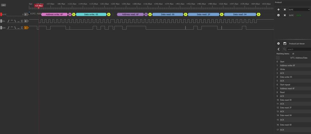

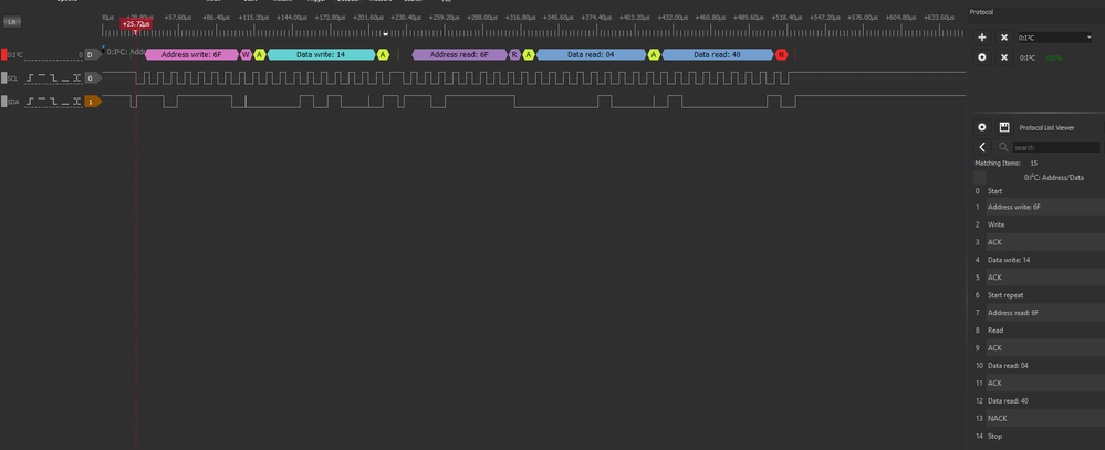

READ 2 bytes is good:
READ 3 bytes is bad:

Arbitration loss indicates that something is wrong with that last NAK (and the picture indecates the same).
Try decrease pullups on SDA, increase timing, and observe with oscilloscope.
