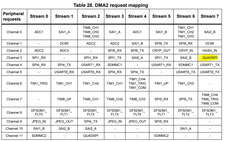

Hello.
I have a problem. I have this function:
/*instruction = 0x0B - Fast read

And i have a problem with this line:
while (!(DMA2->HISR & DMA_HISR_TCIF7)) {}; //wait to the end of DMA
DMA2->HIFCR |= DMA_HIFCR_CTCIF7;
My program is waiting on 'while'. And I can't find a solution of this problem. Any idea, what is wrong?
But, I check the communication. And you can see,
  1. Fast command (1byte) 0x0B were send
  2. Address (3bytes) 0x00 were send
  3. dummy cycles (8bits) were send (but, here is anything wrong.....)
  4. Data received (32bits)
Do you see anything wrong?
#nucleo-f767zi #qspi-flash #stm32f7-dma

Posted on February 09, 2018 at 15:13
Read the errata - there are two significant problems with QSPI, which may affect your piece of code. Don't use dummy bytes.
