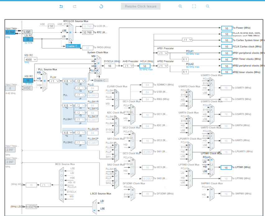

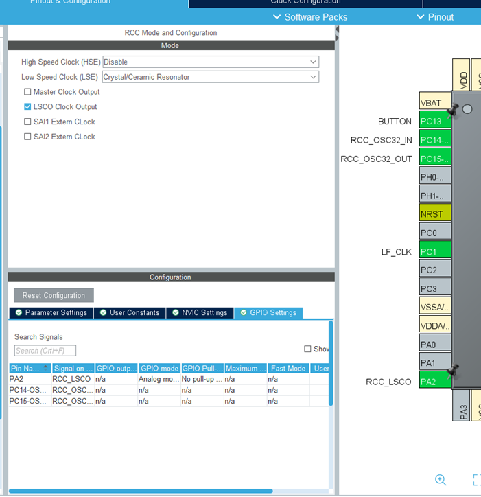

I have entered the following in MX and do not see the crystal frequency on PA2....what else do I need to do here?

check LSERDY flag in the RCC Backup domain control register (RCC_BDCR) that indicates if LSE is in stable condition and running

The LSERDY bit is a '1'
Supposing that errata sheet does not mention such behavior,

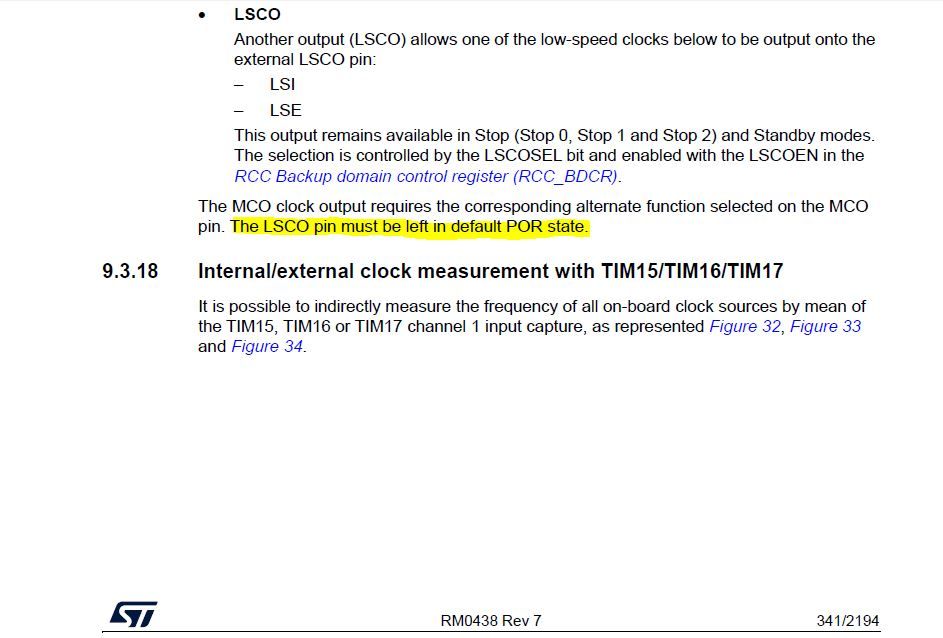

Check first if LSCO pin is is not configured by initialization software. Leave it at POR state.
0693W000008xLZHQA2.jpgIn RCC_BDCR register check LSCOEN and LSCOSEL bits if both set.
Try to enable LSESYSEN bit and wait for LSESYSRDY to set. ( normally this is not mandatory to enable the LSE system clock)
Note that to change these bits "on the fly" , DBP bit in PWR_CR register must being set before.
Try also to redirect the LSE to MCO pin to observe the behavior.
