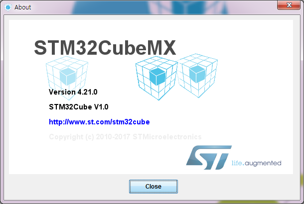

Posted on June 15, 2017 at 13:45
First of all, thank you for your answer.
I just upgraded the CubeMX as advised
  and tested the Ethernet communication after fixing some minor compilation errors.
But the situation is the same.
The source codes doesn't seem to be quite different between 2 versions.
When the problem happens, DMASR is set as 0x00680484.
RBUS and TBUS are both set.
If I clear RBUS and TBUS from a different thread in this situation,
  some Ethernet frames are sent, but immediately RBUS and TBUS are set.
So, traffic is blocked again.
Anyhow, please help me to resolve this issue.
