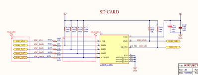

sd card scematic   (part number-GTFP08431BEU)

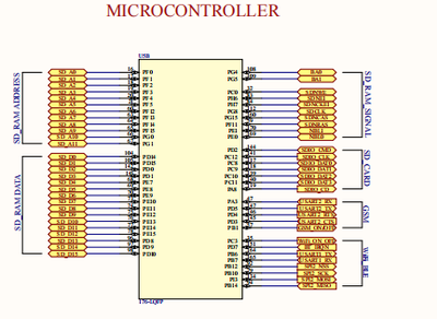

Microcontroller scematic  -

The exact san disk model? (So I can look at the datasheet)?
Possible to add a picture of the physical setup? Wires etc.

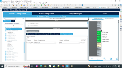

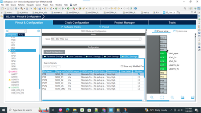

.IOC file pictures of:
-  FATFS Platform settings
- SDIO GPIO settings

sd card schematic-
SDIO GPIO Setting

When exactly do you get the error? If while opening, you may need to create/format a volume on the logical drive before opening it. Also, it is possible that the issue is linked to your hardware setup. You can check the Getting started with STM32F4xxxx MCU hardware development - Application note section 8.4.1, guidelines are proposed to help with design interface connectivity of SDMMC.
The total capacitance of the SD memory card bus is the sum of the bus master capacitance. CHOST, the bus capacitance CBUS itself and the capacitance CCARD of each card connected to this line. The total bus capacitance is CL= CHost + CBus + N*CCard where Host is STM32F4xxxx, bus is all the signals and Card is SD card.
