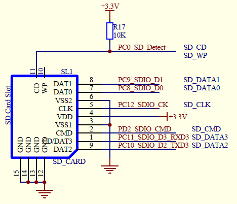

    September 8, 2013
    Posted on September 08, 2013 at 07:53
    Here's the connection to the card,
    Please correct me if I'm wrong
    STM32 --> SD card
    PC8 ---> pin7
    PC9 ---> pin8
    PC10 ---> pin9
    PC11 ---> pin5
    PD2 ---> pin2
    This is the configuration I used

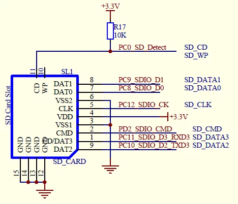

    Tesla DeLorean
    Guru
    September 8, 2013
    Posted on September 08, 2013 at 14:13
    Where's PC12 go? What about the card detect switch?
    This is a schematic of a card configuration, I'd be using pull-ups for all but the clock pins
    Personally I use MicroSD cards, they run faster, but ST's code works on 2GB and lower cards better.
    antonius
    antoniusAuthor
    September 8, 2013
    Posted on September 08, 2013 at 14:33
    Let me correct it :
    STM32 --> SD card
    PC8 ---> pin7
    PC9 ---> pin8
    PC10 ---> pin9
    PC11 ---> pin1
    PC12 -->pin5
    PD2 ---> pin2
    Please correct me if I'm wrong thank you
    Tesla DeLorean
    Guru
    September 8, 2013
    Posted on September 08, 2013 at 15:06
    I would appear to have confirmed the connectivity.
    You should evaluate the SDIO functionality outside the context of the USB MSC.
