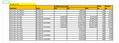

I have a project which runs fine using CMOX_PQC_ML_DSA_44_DET_SIGN_LOWRAM_ALGO but I would like to see how much faster I can get with CMOX_PQC_ML_DSA_44_DET_SIGN_ALGO. When I use it, cmox_pqc_dsa_sign returns 0x9000c, which apparently means "Not enough memory".

There is a "non documented" macro size_t cmox_membuf_getMaxUsed(const cmox_membuf_handle_st *P_pMembufCtx) to get the actual memory buffer used by the algo.
If you define the higher-level context ctx that is cmox_pqc_handle_t you just need to invoke:
cmox_membuf_getMaxUsed(&ctx.membuf_str) to obtain the maximum amount of memory used by the membuf during the previous computation. Note: remember to reinitialize the context (thanks to the construct) to reset that counter.
I will ask to add it documented in the next release of our library.
Please find below some measurement on H5 to give you idea about the performance gain for each configuration.

so the memory is not the stack nor the heap, it is the buffer size that you pass to
cmox_pqc_dsa_construct
give it 31K and then CMOX_PQC_ML_DSA_44_DET_SIGN_ALGO works!
