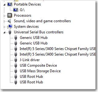

I have a question for : Question for STM32 USB Full Speed Device Library V2.2.1 How can I use SD card on Mass_storage demos ? is it connected via SPI or SDIO ? or I can choose ? and how can I connect my USB to it ? where can I find the configuration for it ? I have PA11 and PA12 connected to USB port. Thanks a lot- Mark as New

I would appear to have confirmed the connectivity. You should evaluate the SDIO functionality outside the context of the USB MSC.Up vote any posts that you find helpful, it shows what's working..

I don't see a schematic, looking at the silk-screen suggests SPI, so no
The CD (Card Detect) is not on the CARD, but the SOCKET, it is a switch actuated by the card when isserted. This SOFTWARE may check this pin, and then not try to initialize/communicate with it. If you don't have the CD, then you'll need to defeat the testing for it. I used the following with the STM32F4-DiscoveryUp vote any posts that you find helpful, it shows what's working..

Hard for me to judge, I think there's enough material there to work with.
The switch typically makes to ground when the card is inserted, but rather than wire it up one could simply defeat the test within the code.Up vote any posts that you find helpful, it shows what's working..

so just make it CD = 0 in the code then...?
I just make : GPIO_ResetBits(SD_DETECT_GPIO_PORT, SD_DETECT_PIN); // set pin low- Mark as New
‎2013-09-11 8:49 AM
No, defeat the test, for example by not doing it, and always returning SD_PRESENT?

‎2013-09-12 4:30 AM
AGAIN NO, Does that even make the pin low? The pin is in input mode.uint8_t SD_Detect(void)
return SD_PRESENT;
