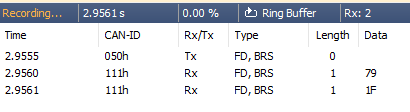

question about the FDCAN bootloader -- special reset command
Snaku
I read this page
https://community.st.com/t5/stm32-mcus/understanding-the-bootloader-issue-with-the-go-command-on-the/ta-p/750839
but i still have problem to perform the speical reset command of the STM32H5 FDCAN bootloader.
I sent 'Special Command' (0x50) to FDCAN bootloader, it relpy me an ACK (0x79) but the CAN-ID change to 0x111 ?
Is there a good example can show me the CAN log for this special reset command ?
Thank you,
Snaku
