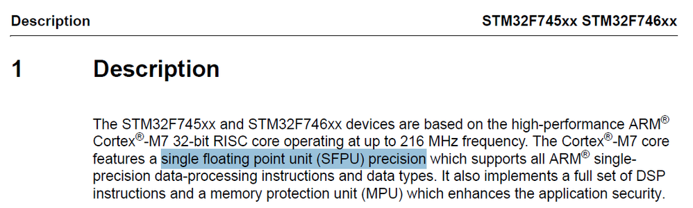

Question about the assemble code for floating point computing: the FPU didn't be used in fact?

Your CPU only has a single precision FPU, this is why it the double precision computations are being done in software, it is using the FPU registers as extra holding space.
The FPU isn't inherently complicated, it only implements fairly basic math functionality which you can gleen from the opcode name. The cleverness with come from how you manage the register resources to minimize the movement in/out, and make the math flow. The FPU does not hold higher precision intermediate results.

‎2017-08-03 4:15 PM
Thanks for your answer. It's helpful. the FPU on STM32F746 is actually only support single point computing.
in manual
Thanks again

And, do you think it is more efficiency to load the data from the source address and travel back to the destination than LDRD them directly to the target address?
What's the purpose of the compiler to let the data travel through the FPU register? I didn't find there is any need to holding the data in FPU.

The 2MB version has the newer core and the FPU-D, they should have built the original CM7 with this, like Atmel did.
‎2017-08-03 6:24 PM
I'm not going to argue compiler performance/behaviour here. Not sure the optimization level here, but no doubt a hand crafted routine where you understood the math/algorithm could be more efficient.
