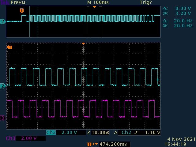

So, what happens, exactly then? How do you observe it? What's the signal source, does it have clean edges?
Read out and check/post content of TIM registers.
The signal from the encoder looks good, clear transitions.

For example, we don't know how exactly do you read out TIM4_CNT. Can't there be the problem? Try to read out TIM4_CNT directly using debugger when the failure occurs.
Also, (inadvertent) reprogramming the two related GPIO pins would result in the same effect - i.e. read out and check relevant GPIO pins content, when the failure occurs..
Did you check the waveforms - directly on the pins - when the failure occurs?
