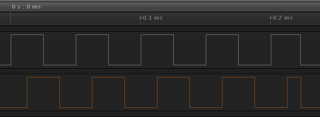

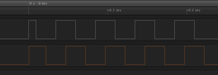

Hi, i'm trying to use timer2 to generate two output shifted by 90 degree, like an encoder emulator. The idea is using the period of the timer2 to set the frequency, and set two output compare ch2,ch3 to set the output.
This is the code i'm using to set the timers:

And this the interrupt:
void
HAL_TIM_PeriodElapsedCallback(TIM_HandleTypeDef *htim)
if
(htim == &htim2){
if
(currentPackets == numPackets)
HAL_TIM_OC_Stop(&htim2, TIM_CHANNEL_2);
HAL_TIM_OC_Stop(&htim2, TIM_CHANNEL_3);
HAL_TIM_Base_Stop(&htim2);
currentPackets++;
Sometimes the first output is smaller then the others: 0690X00000605L8QAI.png Or the last: 0690X00000605L4QAI.png Why? Any idea? Thanks Stuk #!stm32 #!timer #!outputcompare

mark239955_stm1
Posted on February 02, 2016 at 07:02
@stuk
If you need to use the TIM2 interrupt, set the URS flag in CR1 instead of the UDIS flag.  Then you will get IRQ's on counter rollover/under, but you won't get an IRQ when you reset the counter with the UG flag.
