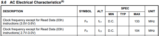

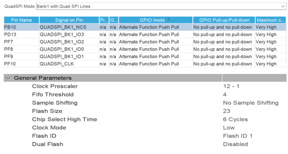

We are creating a driver for a W25Q128JV Winbond Nor Flash chip. We are working with a STM32 H743ZI2 board and communicating on the QSPI peripheral with the help of the HAL libraries. Currently the driver can successfully Write to the chip using standard Page Program (0x02h) and the Quad Page Program (0x32h). We are also successfully doing a Fast Read (0x0Bh) up to speeds of 72MHz and a Fast Read Dual Output (0x3Bh) up to speeds of 36MHz before they start to fail. Currently we are using a 3.3V power bus, so based on the AC Electrical Characteristics seen in the datasheet we expect these commands to work up to speeds of 133MHz.0693W00000FBEtWQAX.pngBelow is the CubeMX setup we are using for the QSPI peripheral:
0693W00000FBEyCQAX.png*Scaled clock down to 12MHz for logic analyzer testing
If you prefer the generated code that is also provided below.

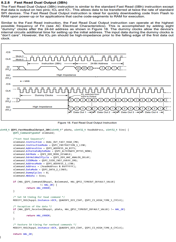

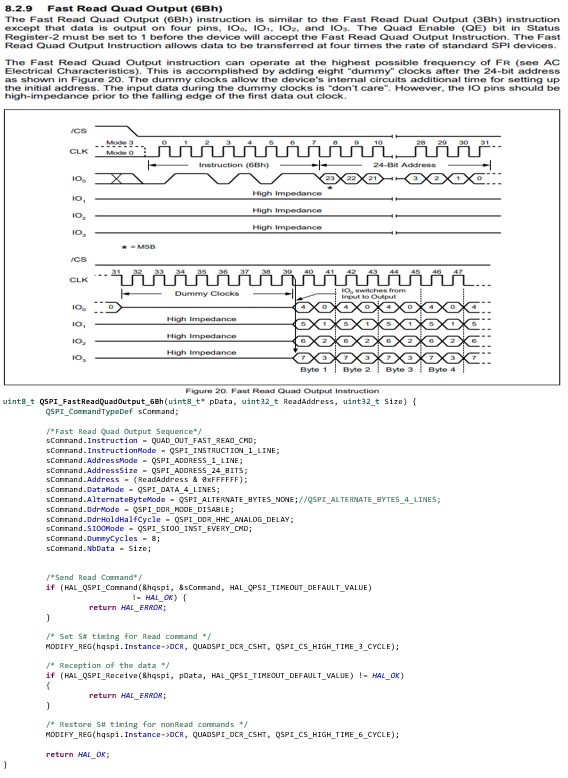

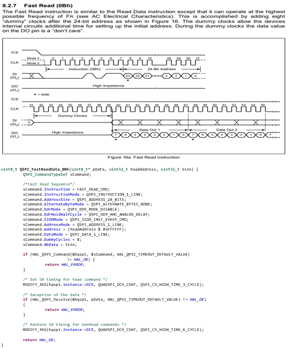

Here are the functions we are working with to drive the flash chip and the instruction description from the datasheet.

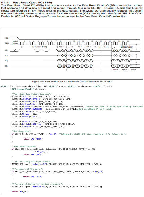

0693W00000FBEyRQAX.png0693W00000FBEyWQAX.png0693W00000FBEybQAH.pngInitial thoughts on seeing 16bytes from the Fast Read Quad I/O was that the Wrap Bits were not actually defaulting correctly so we included a manual setting of the Wrap Bits using the Set Burst with Wrap (77h) to guarantee we had the right configuration there. The function that does this is as follows.

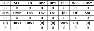

Before we do any read or write operations we write to and check the values in our status registers to ensure the QE bit is set to 1 and that DRV1 and DRV0 are set to 0 making the Driver strength 100%.
Here are the register values we read out after doing our setup for Default Driver Strength 25%:

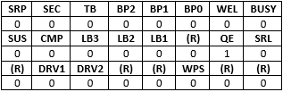

0693W00000FBEylQAH.pngHere are the register values we read out after doing our setup for Maximum Driver Strength:

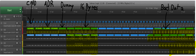

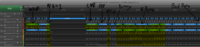

0693W00000FBEyqQAH.pngHere is the Logic analysis we are seeing for both the Fast Read Quad Output and Fast Read Quad I/O commands. They both receive the first 16 bytes of good data and then get the same bad data later down the line, random bytes but consistent random bytes. Note: for all reads we are reading the first sector of the Winbond chip (4KB) which contains 16 pages (256Bytes) each populated with values 0-255. This data is known good as we successfully read the data out using the Fast Read command before trying the Quad Read Commands.
Logic Analyzer of Fast Read Quad Output
0693W00000FBEyvQAH.pngLogic Analyzer of Fast Read Quad I/O
0693W00000FBEz0QAH.pngThe two things we are trying to find out here is 1) Why are the Quad Read Functions only returning the first 16 bytes of data instead of a whole sector and 2) What could be preventing Read commands from working at higher frequencies than 72MHz?
