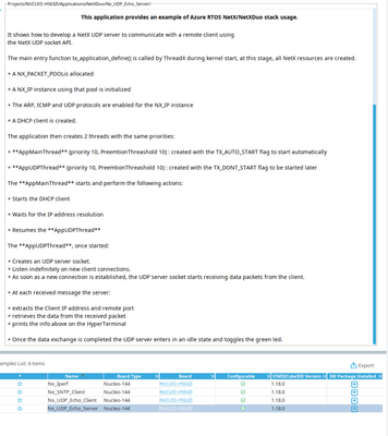

Best is to have a look at some example to double check all settings are ok, including Ethernet pins that can have multiple configurations while Nucleo board requires one specific.

I suggest you run one of the provided examples - it is an easy path to start with.

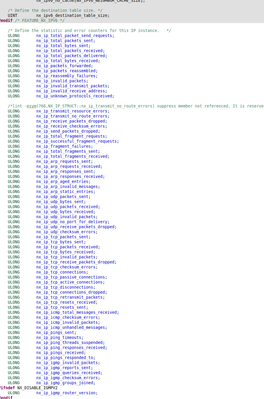

Later you can monitor network activity - NX_IP element has ( and in your design are enabled) a lot of activity counter.
