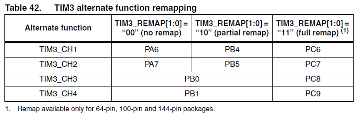

What is the difference between GPIO_PartialRemap_TIM3 and GPIO_FullRemap_TIM3 as used in the GPIO_PinRemapConfig() call?
Posted on September 03, 2013 at 22:46
Two vs Four channels?
Bill Lewis
Posted on September 03, 2013 at 23:46
Ahh!  I searched the forum and google'd but I never thought to look in the datasheet.  Doh!
Thank you, Clive!
If one uses Full remap but PC6 is not set to Alternate Function, will PC6 still function as a general purpose I/O pin?
Posted on September 04, 2013 at 02:40
Yes PC6 can remain as a GPIO, as can any channels you are not using, or ones which you are only using internally.
The F1 provides for peripheral/block remapping, the newer designs (L1, F2, F4) provide for a more flexible pin level remapping.
