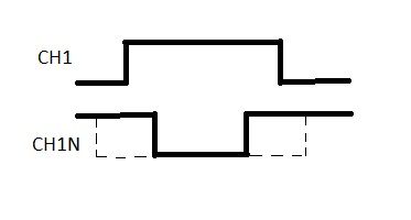

hi,
I found a problem to generate a PWM signal like this one:
i thought that we can do this with TIM1 by insertion of a DEAD TIME but when i inserted a dead time i obtained a signal lîke this one: 0690X00000602y0QAA.jpg
can someone help me plz ?

Haha no Clive it's not a homework :) a project. we have to control a stepper motor. i need these signals :\

No mention of frequency, or period/duty
At 1 KHz, use two channels in PWM and alternate 0 and 80% ON time between channels at the update interrupt. Would give you a 500 Hz, 2 phases, 800 us ON1, 200 us OFF, 800 us ON2, 200 us OFF, with a 2000 us CYCLE
