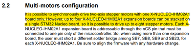

Additionally, in the document UM1964 User Manual, it is stated that it is possible to control up to 8 stepper motors using an STM32 series MCU.

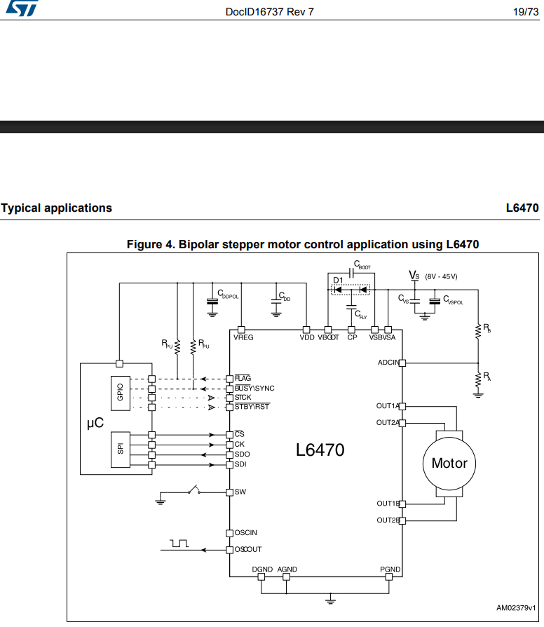

That's the User Manual for the X-NUCLEO-IHM02A1 two-axis stepper motor driver expansion board based on L6470.
The L6470 is a driver chip which handles all the motor control - so that the host MCU doesn't have to do any of it:
https://www.st.com/resource/en/datasheet/l6470.pdf#page=20
So, using the L6470, you don't consume any of the timers on the host MCU.
PS:
and the 8-motor limit seems to be just down to the number of chip-select options available on the X-NUCLEO-IHM02A1 boardd

Any limitations or considerations regarding timer availability, PWM channels, or control implementation
using the IHM02A1 boards you dont need PWM etc. , not even a H7 cpu, can be much smaller type;
the boards->motors get just commands by SPI connection from the cpu.
The expansion board includes two L6470s, a fully-integrated micro stepping motor driver used to control stepper motors by means of high-end motion control commands received through SPI.
