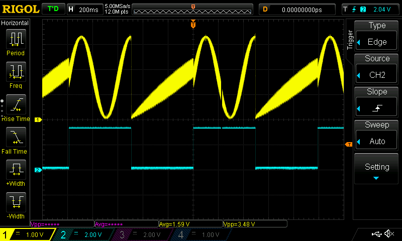

I want to change the array who sources the DMA, and I can't,
I don't Cube but having a cursory look at HAL_TIM_PWM_Stop_DMA() it appears that it does not stop DMA itself, only disables the trigger in timer.
If you want to change the memory pointer in DMA you can do that only if you disable the given DMA channel (or in double-buffer mode you can change the 'other' address, but that's not what you want). I don't know how to do it in Cube - this is exactly the reason why I don't use it.

The HAL_TIM_PWM_Stop_DMA() it's not a Cube thing, but a HAL thing, when I generate the code with Cube it not even put the function HAL_TIM_PWM_Start_DMA().
I didn't look it before, but now I can disagree with you. I was debugging the process step by step and when we reach the function HAL_TIM_PWM_Stop_DMA(), we are going here:

Then when I reach the bold function the DMA stops flushing numbers into CC1 (the pwm remains where it is), and when the function  , TIM_CCxNChannelCmd(htim->,Instance, Channel, TIM_CCxN_DISABLE), is processed then the pwm goes down.
Which is not clear yet is how much of 'disabled' is the DMA after __HAL_TIM_DISABLE_DMA, the definition of this is:
♯ define __HAL_TIM_DISABLE_DMA(__HANDLE__, __DMA__) , , , , , , , ((__HANDLE__)->,Instance->,DIER &,= ~(__DMA__))
from the file stm32f4xx_hal_tim.h
what else is needed to unlink the DMA from the current array? I tried with multidimensional array too, with the same result.
also, I don't know about the double buffer you say, where I can read more? I'm looking for a way to generate the array on the fly (because I will need many, and the memory will be not enough), and then change the array for the next step of the waveform. Thanks for your time!

As I've said and you've confirmed, the function in question disables the
DMA triggering
in timer (by clearing the respective bit in TIMx_DIER) but does not disable the
DMA channel
(by clearing DMA_SxCR.EN). Only after DMA channel is disabled, the memory address register can be written - see DMA stream x memory 0 address register (DMA_SxM0AR) subchapter of DMA chapter in RM.
Reference manual for your SMT32, DMA chapter, Double buffer mode subchapter.
Posted on January 04, 2018 at 00:11
Fantastic!
changing the loop to this it works:
