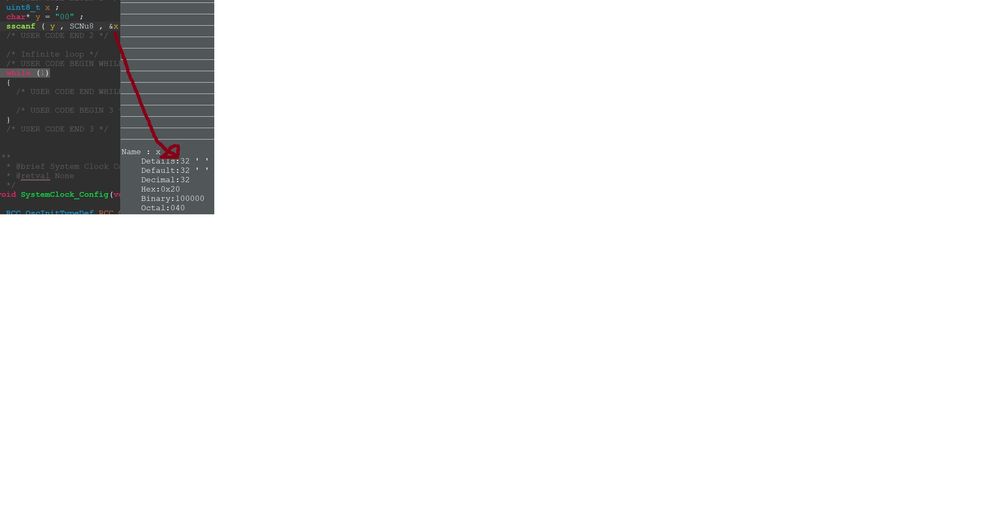

I was expecting to get x = 23 after following code:
  uint8_t x ;
  char* y = "23" ;
  sscanf ( y , SCNu8 , &x ) ;
but I got always x = 32 regardless of the value in string.
