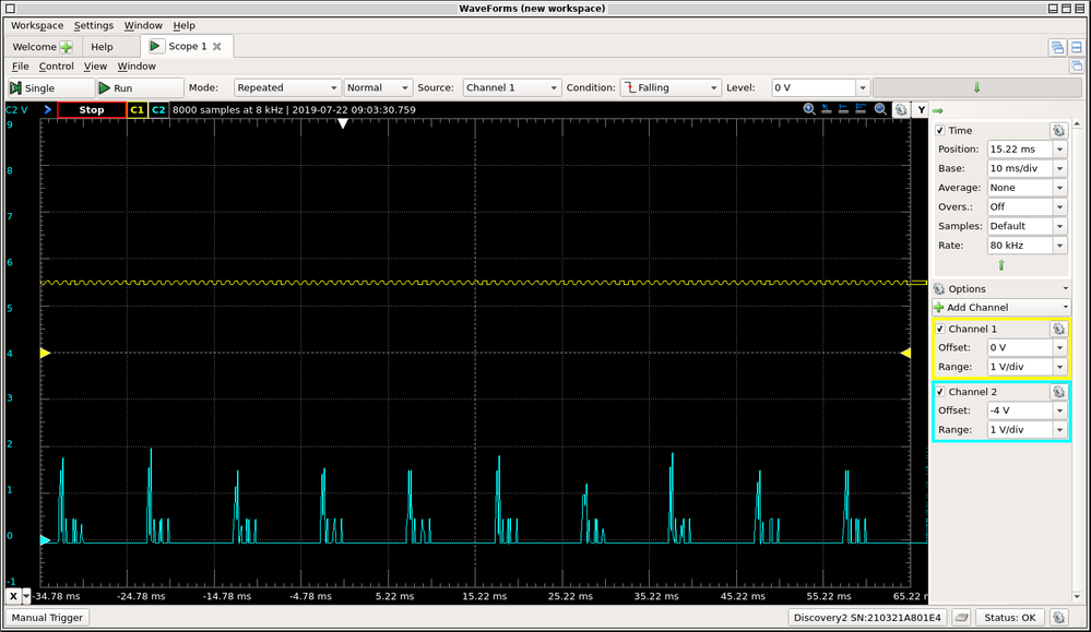

I've got NUCLEO-F429ZI board and I'm trying to write simple communication via SPI. I've generated code from CubeMX for SPI1, compiled it under Atollic TrueStudio and run. Unfortunately I cannot get SPI working. I mean I have no clock signal on SCK PA5 pin and no usable signal on MOSI PA7 pin.
Here is my code generated by CubeMX with my simple transmission example:

And here is screenshot from my oscilloscope:
where:
  • yellow is connected to SCK PA5 pin
  • green is connected to MOSI PA7 pin
This screenshot has been caught while program running. I'm wondering why SCK (yellow) signal still has value about 1.6V and almost doesn't change. I think it should switch from 0V to 3.3V, but it doesn't.
Seems like the GPIOA has not been configured properly, but I've checked it and here are values of the registers:
GPIOA->MODER = 0xa800a800
GPIOA->OTYPER = 0x0
GPIOA->ARFL = 0x55500000
I've also included .IOC configuration file for CubeMX for checking.
My question is: why there is no proper SCK clock signal and MOSI output?
Any ideas? How to fix it?

waclawek.jan
Read out and check the SPI registers' content.
What's on the o'scope is alarming, but then we don't know what exactly, and how, do you measure.
Check if there is no conflicting connection on the given pin. Try to wiggle it with a simple code setting it to GPIO.
WKowo
It turned out, that my oscilloscope had bad power supply - it was powered by USB. I fixed it (changed the USB cable) and now the SCK, MOSI ans CS signals are looking properly on my oscilloscope.
Thank you for your rapid answer.
