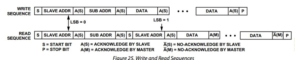

I am trying to read capacitance and temperature from the AD7746 capacitance-to-digital converter, using STM32F103 and HAL I2C library (SDA and SCL pulled up with 2k and Vcc = 3.3 V). I did it before using AVR (using Codevision) and it worked fine, but now it doesn't work properly:

This is part of the AD7746 datasheet that explains write and read:
0693W000004JenCQAS.jpgSo for reading one byte of capacitance or temperature data you must first send start bit, write 0x90, and then write the address again, send start bit, write 0x91 and then read data but I get 6 similar data.

Is "Reset_address" a pointer? if not ship the address of this uint variable into this Hal function
Shp.1
In datasheet mention if stop occur, address set to 0x00
but in HAL I changed the address from 1 to 6 in this code but all 6 data are similar
