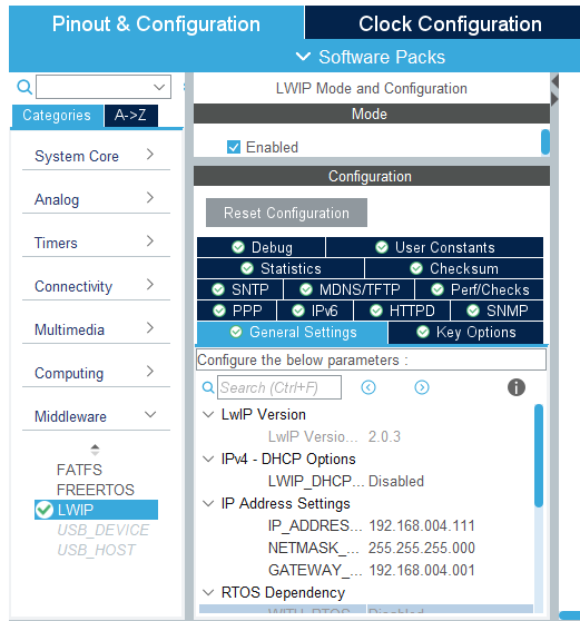

I am using the STM32F107VCT6 controller. use STMcubeIDE.
I write the code of the UDP Server. but when I change the IP, subnet, and Gateway using TCP and reset the device. I do not get Broadcast info or the udp_recv function not working.LWIP.PNG

First, I Set the Value of IP: 192.168.4.111, SUBNET: 255.255.255.0, GATEWAY: 192.168.4.1.
and Using TCP, I Change the IP:10.10.10.11, SUBNET: 255.0.0.0, GATEWAY: 10.10.10.1. I change the value in LWIP. C file (Call MX_LWIP_Init() Function). then I Call UDP function. First Bind the UDP, then wait for receive DATA. But not get any Receive data.
For Data Sending I Use Docklight Application and for UDP connect I set The Docklight IP (example UDP:255.255.255.255:1225).
