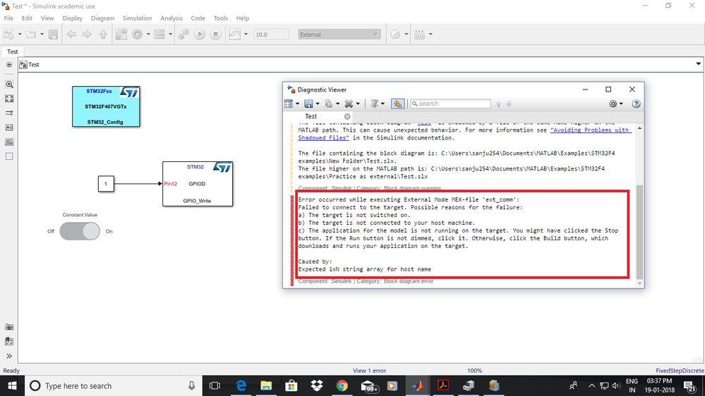

hello i am using STM32_Mat_target 4.4.2 but i am not able to communicate my board stm32f407vg externally i am getting error for connection any one please help me regarding this

You need to give more details about the 'error' you are receiving.
What basic connectivity checks have you done? eg, check in Device Manager ... ?
Is there no troubleshooting guidance in the documentation on the linked page?

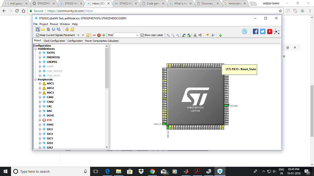

Here i attach the error am getting and i followed the step as per the manual. can u please suggest me what exactly happening. also please tell a configuration required for this. her i attached configuration of cubemx also. you help is more appreciated.

The error message gives you 3 possible causes for the problem - have you checked each one?
Please give full details.
