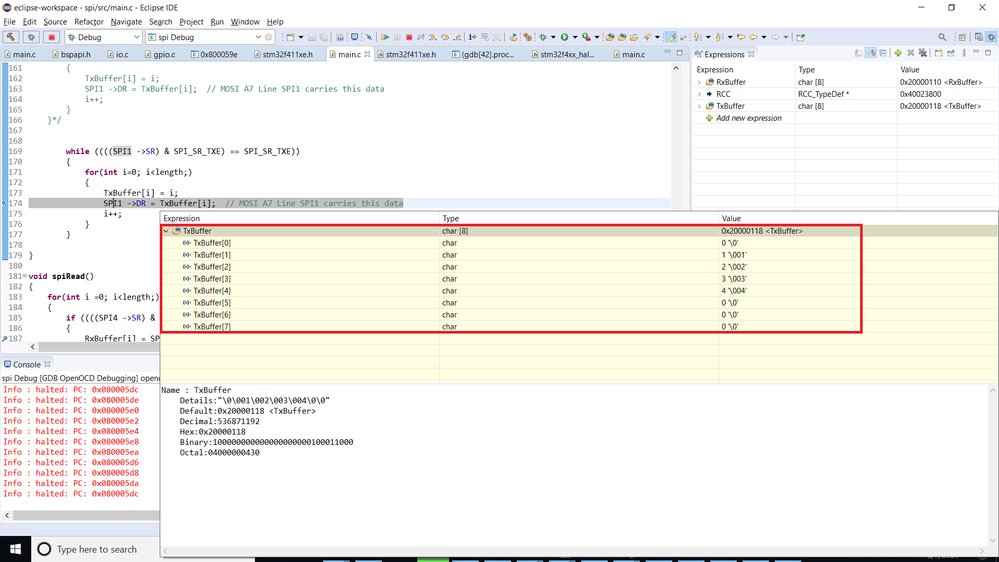

I am new to this nucleo board ( Nucleo-64 , STM32F411-re). I've configured SPI1 port as master and SPI4 port as slave. I am trying to establish communication between these two ports and verifying the data weather its reflecting on SPI1-> DR data registers.
I am having some doubts
- Is it possible to establish communication between two SPI ports on same board( SPI1 and SPI4 )
- Do this board has any loopback register so that I can verify the data I am sending
- Am I configured SPI registers correctly?? for above mentioned task
- Am I configured SPI NSS pin correctly??, provide I am configuring in Software mode as mentioned in the usermanual.
While debugging and watching the value of SPI-> DR register I am not able to see any values in the SPI Data register

Didn't look at all register setup details, just one remark: you have to poll in an endless loop for SPI_SR_TXE and SPI_SR_RXNE
conditions. Therefore, you need another while loop within the for.
Yes, thats possible. But I doubt that it will work with a sequential spiWrite() and spiRead() because write and read occur on the same SPI clock cycles. For short messages the FIFOs might help, but in general people use interrupt or DMA features for simultaneous write+read.

I've edited code as you've mentioned above, Still I couldn't find an changes also the data isn't reflected/ written to SPI Data register. I have attached screenshots for your reference. If subsequent read and write is a problem, I had change the code such that It performs only spiWrite(), still the data is not written into the register.
while ((((SPI1 ->SR) & SPI_SR_TXE) == SPI_SR_TXE))
for(int i=0; i<length;)
TxBuffer[i] = i;
SPI1 ->DR = TxBuffer[i]; // MOSI A7 Line SPI1 carries this data
i++;
You have to wait (poll) for each and every individual byte/char.
Here is a small example using SPI2 and SPI3 on a Nucleo-F446RE. It assumes that the GPIOs are already configured and copies the string from tx to rx buffer via SPI:
static char tx[16] = "Hello\r\n";
static char rx[16];
SPI2->CR1 = 0;
SPI2->CR1 |= SPI_CR1_SSM; // NSS in software
SPI2->CR1 |= SPI_CR1_SSI; // Internal slave select
SPI2->CR1 |= SPI_CR1_MSTR; // master mode
SPI2->CR1 |= 5 << SPI_CR1_BR_Pos; // 64:1 bitrate
SPI2->CR1 |= SPI_CR1_SPE; // SPI enable
SPI3->CR1 = 0;
SPI3->CR1 |= SPI_CR1_SSM; // NSS in software
SPI3->CR1 |= SPI_CR1_SPE; // SPI enable
for( int i=0; i<strlen(tx); ++i )
while( !(SPI2->SR & SPI_SR_TXE) ); // poll for TX empty
SPI2->DR = tx[i];
while( !(SPI3->SR & SPI_SR_RXNE) ); // poll for RX non-empty
rx[i] = SPI3->DR;
HAL_UART_Transmit( &huart2, rx, strlen(rx), HAL_MAX_DELAY );
Note that this is a toy example because the slave SPI needs to poll all the time to listen for (and not to miss) incoming chars. So, finally you might want to add interrupt handling or DMA. Note also that slave select is not handled here.
