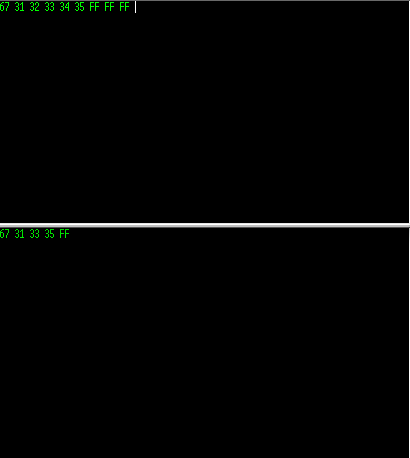

Hi all, I've recently been teached about how to manage streamed data in this case for managing commands, then my code is like the following explanation: I've programmed the uart2 to receive the streamed data byte to byte and I've been storing it in a buffer, every time arrives a byte then a flag is set and the function that analizes the streamed data takes the address of the reception buffer, inside the function that analizes the streamed data I declared several pointers to a struct to manage differente kind of commands.
All the commands has a code in the first byte and a termination suffix, the suffix is 0xff 0xf 0xff and the command code are the following:
NEX_RET_CMD_FINISHED (0x01)
NEX_RET_SLEEP_CURRENT (0x86) (134)
NEX_RET_AWAKE_CURRENT (0x87) (135)
NEX_RET_EVENT_TOUCH_HEAD (0x65) (101)
NEX_RET_CURRENT_PAGE_ID_HEAD (0x66) 102)
NEX_RET_EVENT_POSITION_HEAD (0x67) (103)
NEX_RET_EVENT_SLEEP_POSITION_HEAD (0x68) (104)

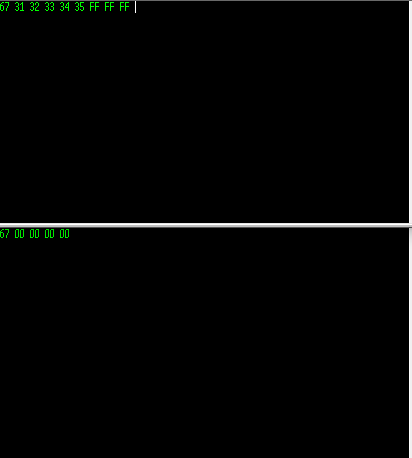

and some of the conditions to analize the stream works, some other doesn't works; by example, the conditions that compares with the macros NEX_RET_CMD_FINISHED and
NEX_RET_SLEEP_CURRENT works perfectly and those commands only has four bytes being the prefix and the suffix, the condition that works with the macro NEX_RET_EVENT_SLEEP_POSITION_HEAD also works well but the condition that works with the macro NEX_RET_EVENT_POSITION_HEAD doesn't works well thoug both commands has the same 9 bytes long, when I send to the other uart the content of the pointer sleepingEvent then it prints this
the text in the upper console s what I sent through the uart2 and the lower console is what I suposse is the content of the pointer to a struct sleepingEvent, now seeing that I can note that the content of the stream beyond the prefix is lost or not properly stored (I don't know which of that causes are) and I don't know how to solve it.
If I print directly the content of the pointer incomming then it prints what is in the lower console of the following image
0693W000006EOrLQAW.pngwhat I see there is that the uart_transmit function is printing bad what is received.
So, can someone help my to solve the problem?
