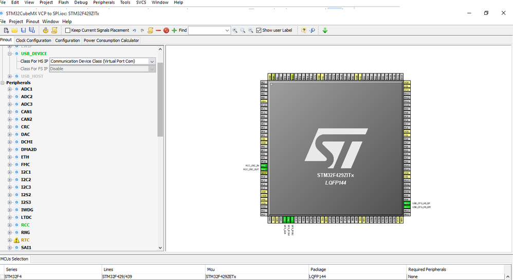

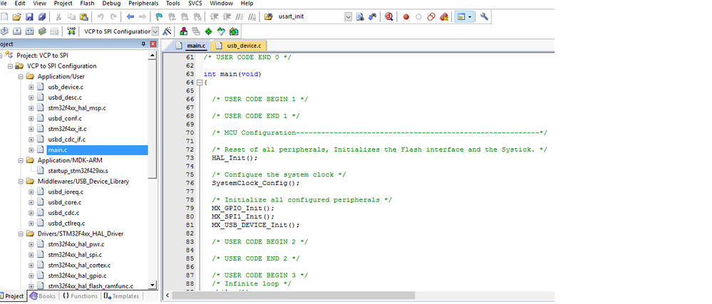

Hi !!
I created a project cubemx configured for the virtual com port.i configurate it following the steps of : https://my.st.com/public/STe2ecommunities/mcu/Lists/STM32Java/Flat.aspx?RootFolder=https%3a%2f%2fmy.st.com%2fpublic%2fSTe2ecommunities%2fmcu%2fLists%2fSTM32Java%2fstm32f429%20Discovery%20vcp%20with%20STM32CubeMX%20drivers&FolderCTID=0x01200200770978C69A1141439FE559EB459D758000F9A0E3A95BA69146A17C2E8...
the problem is the manager of péréphirique does not recognize the driver in the com port my operating system windows 10 x64bit catre is my discovery STM32F429ZIT

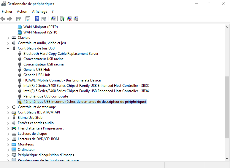

Posted on September 23, 2015 at 21:23
Hello! I am having the same problem (Windows 10 64bits) and Windows does not recognize the driver ... The CDC appears in Device Manager but does not recognize the driver ...
I've tried the tips (install with port driver, increase the heap) and not solved ... has no example of CDC for STM32F429-Discovery Board ....

Posted on September 24, 2015 at 05:24
Microsoft changed something in Win10 that broke the (WHQL certified) driver, seen several reports now.
