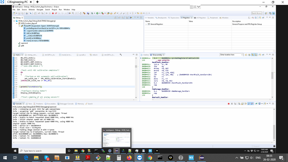

I am working on a STM32F103VEtx MCU. In my firmware I have redirected the printf function to a UART for debugging purposes. When I start running the code, the printf function causes the hard fault handler to hit. Please see the call stack attached below
Thread #1 (Suspended : Signal : SIGINT:Interrupt)
prvGetRegistersFromStack() at stm32f1xx_it.c:109 0x800441a
<signal handler called>() at 0xfffffff9
std() at 0x8007abe
__sinit() at 0x8007b76
printf() at 0x8006dac
main() at main.c:130 0x800400c
It seems like std() function call triggers the hard fault. Please help me to figure out and fix the issue.

‎2020-02-26 10:14 AM
Step through and figure out which instruction causes it. The standard printf uses malloc, which may be causing it.

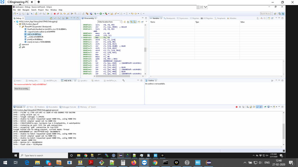

‎2020-02-26 11:13 PM
Thanks for looking into this issue.
Attaching the disassembly code snippet where issue is happening
std:
08007ab9: movs r3, #0
08007abb: push {r4, lr}
08007abd: mov r4, r0
08007abf: strd r3, r3, [r0]
08007ac3: str r3, [r0, #8]
08007ac5: strh r1, [r0, #12]
08007ac7: str r3, [r0, #100] ; 0x64
08007ac9: strh r2, [r0, #14]
08007acb: strd r3, r3, [r0, #16]
It seems like hardfault is triggered from the line of code "08007abd: mov r4, r0". When clicking the std() function in call stack it is jumping to above mentioned line of code. Attaching the screenshot for more clarification.
‎2020-02-27 12:37 AM
A mov won't cause any fault, it's just moving a value of one register to another. It's most likely the next one, storing two words to memory pointed by [r0], which is the first parameter of the function call. So this function is called with a NULL pointer argument.
Get the sources of your C runtime library, and look into it, what could cause it to be called with a NULL pointer.
