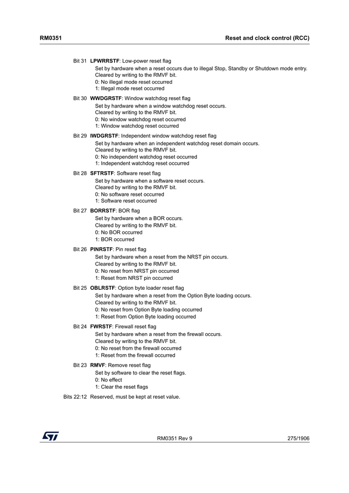

I am trying to detect whether a reset event was caused by power on rather than any other reset such as a button reset or a software reset. I attempted to use
 if (__HAL_RCC_GET_FLAG(RCC_FLAG_PORRST) != RESET)
but the compiler reports that PORRST is not recognized. I tried BORRST and that is recognized but i don't believe that that setting is solely for power on detection.

Maybe read the reference manual?
The device has an integrated power-on reset (POR) / power-down reset (PDR), coupled with a brown-out reset (BOR) circuitry. The BOR is active in all power modes except Shutdown mode, and cannot be disabled.
During power-on, the BOR keeps the device under reset until the supply voltage VDD reaches the specified VBORx threshold.
Therefore at least for these devices POR=BOR and it sets BORRSTF. And in addition the PINRSTF will always be set.

Try using normal register access and symbols from the CMSIS-mandated device header.

I meant https://raw.githubusercontent.com/STMicroelectronics/STM32CubeL4/master/Drivers/CMSIS/Device/ST/STM32L4xx/Include/stm32l471xx.h and you have it under a similar path at your computer...
...but I spoke too soon: unlike some other STM32, the 'L4xx appears to have no PORRST flag in RCC_CSR:
0693W00000aIWTyQAO.pngMaybe POR is indicated by absence of any other flags being set in that register, but that needs some testing.

This is indeed different from e.g. 'F4 where BOR and POR are two different thing and BOR even can be switched off.
