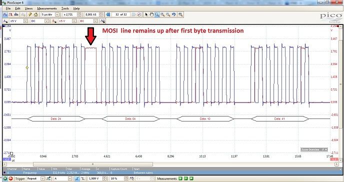

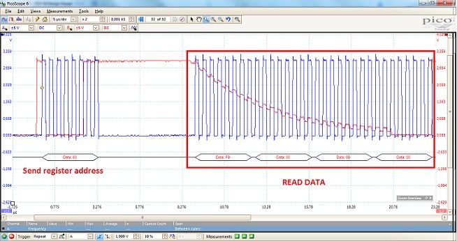

Hi all,
I'm tryng to use SPI in half-duplex mode on STM32F303VC microcontroller. The STM32 act as Master. MOSI line is used as data line for input and output. In my setup I have to send an address register using MOSI line and then read data trough the same line (peripheral is in half duplex) the problem is that after sending one byte, the MOSI line remains at high logical level.. This is not an issue when I need to send multiple data, as shown in figure transmission is fine. The problem is that when I switch to read mode
SPI_BiDirectionalLineConfig(SPI2, SPI_Direction_Rx);
the MOSI line is still up and corrupt the data (second figure) 0690X00000602qdQAA.jpg 0690X00000602qmQAA.jpg #spi-stm32

But the problem is another, the SPI data line remains HIGH after the 8 bit transmission.
(the first image refers to transmission only)

Hi, I finnally come out with a workaround:
after sending the 8 bit address to avoid that data line remains high is necessary to reset the SPI peripheral.
