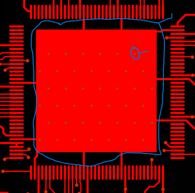

According to some reference it is good to have ground polygon under IC
1. Is it okay to have ground polygon under IC?
2. Does it effects heating issue?
3. I saw two hole behind the IC of nucleo 144 board. What that mean?

Dear @Ironman ,
we do not have an exposed pad for this MCU and package , there is not real interest to have Ground polygon under the package . It will make your routing of other signals more complex . However this is interesting for segregation of Analog routing versus Digital high speed signals if applied close to that blocs .
regards,
STOne-32.
look at this, this is none exposure gndst1.PNG polygons with gnd vias. You mean no need to add this polygons right?
STOne-32
Dear @Ironman ,
yes, I confirm no real need , but it is good technique to have ground vias to other layers on PCB.
regards,
STOne-32.

I am using 4 layer stack
1. Top layer
2. GND 1
3. GND 2
4. Bottom Layer
But I got your point . Thank you
