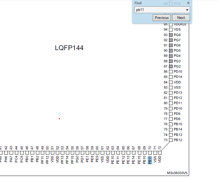

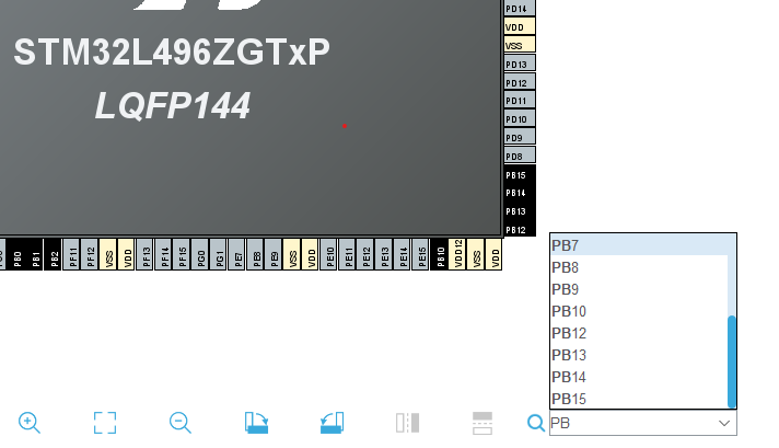

PB11 Missing in STM32L496ZG in STM32CUBE
‎2023-08-28 10:09 PM
‎2023-08-29 12:21 AM

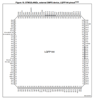

Hello @NIVI ,
The STM32L496ZGTxP is an MCU who belongs to LQFP144 package with "P" mean dedicated pinout supporting external SMPS.
The PB11 is not supported in this package as already mentioned in the Pinout of STM32L496Zx, external SMPS device, LQFP144 pinout figure in the datasheet (figure 10).
Thank you.
Kaouthar
