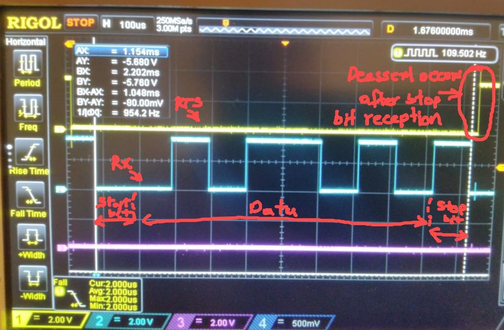

Please find below the the DSO captured waveforms when above issue happens.
According to the datasheet the RTS line should go HIGH during the STOP bit reception. Refer below image for reference.

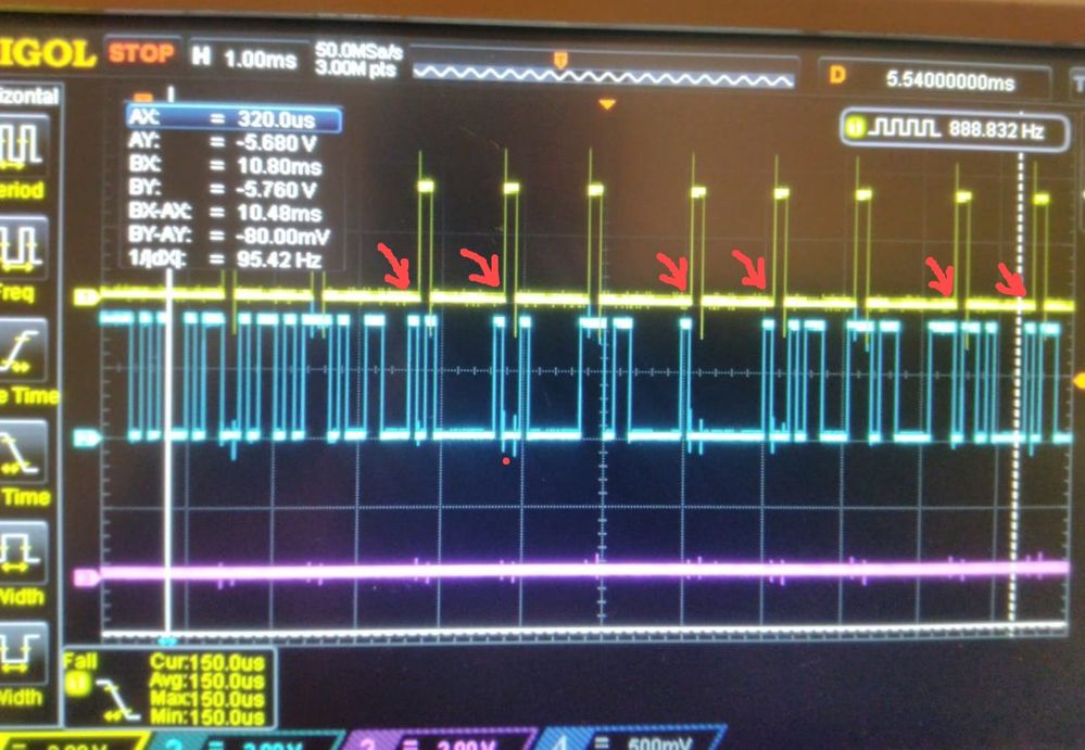

We are transmitting 56 bytes of data packet from Nordic to STM32. Another interesting pattern that we have noticed is initial two out of three consecutive transactions have this issue. Refer the below image.

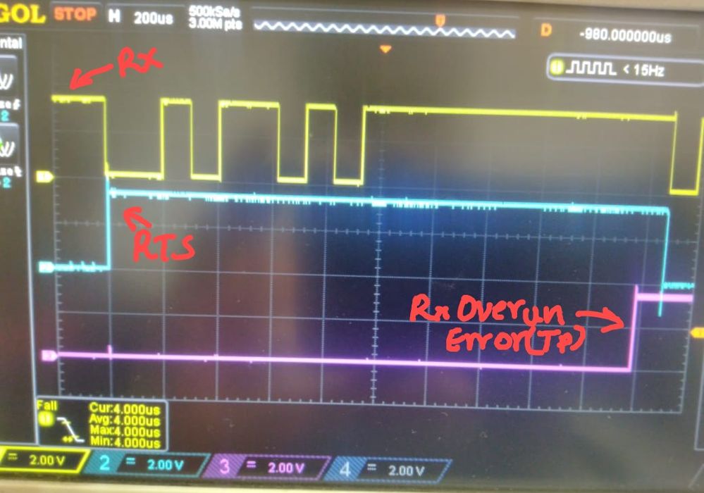

Because of this we are sometimes getting UART overrun error although the RX DMA is enabled. In the below image the Test Point (TP) line is made high when the overun error is encountered in the UART error handler.
