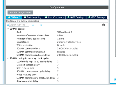

Hi, I am working on a realtime audio DSP product using the STM32H7 with a AS4C4M16SA-7BCN SDRAM chip for long delay line memory. I am using the FMC controller with the settings in the attached photo:
The product processes an incoming audio stream in real time, so this is a very runtime critical application. I have found that reads and writes to and from the delay memory on the SDRAM are by far the biggest drag on overall performance.
Currently I am just accessing SDRAM memory automatically through the C++ compiler, declaring as follows and accessing as I would any other variable:
static float delay_line[48000 * 30] __attribute__((section(".sdram"))); //48000 sample rate * 30 seconds
I am wondering if there are any ways to optimize SDRAM reads and writes to get better performance, either through how I structure my code, or through settings in the CubeMX configurator.
In particular, would it be faster to do sequential reads from consecutive SDRAM locations to a buffer in onboard memory rather than just accessing at random points based on my code behavior? Is there a vector style function that can quickly copy a block of data from the SDRAM to local memory? Would this approach be likely to provide a noticeable performance increase?
Please advise, thanks!

For MCU access you can cache the SDRAM see MPUConfig() examples
DMA into memory won't cache.
You should be able to use MEM2MEM DMA modes to move data in the background, but that might add contention.
You'll have to benchmark to see the amount of performance you can trade doing processing on-board, and then migrating out to SDRAM. Generally the least amount of moves, and simpler the pipe-line the better.
On the F4's the SDRAM was of the order of 6x slower than Internal-SRAM.
The DTCM is not cached, and is better than 0-wait state outside the core. If you can keep things small-and-fast, do that.
If you use the SDRAM as the dynamic memory pool (HEAP) and use pointers you can likely test and adapt things more quickly.
Don't use SDRAM for STACK
