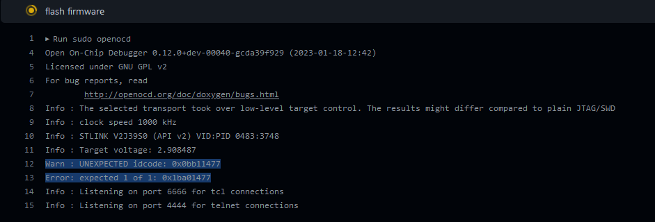

UNEXPECTED ID code?, the discovery board is original.
the onboard stlink is updated to latest version.
If i google this Error, i get people trying to flash ST clone mcus, but mine is original.
This is my openocd.cfg file:
source [find interface/stlink.cfg]
transport select hla_swd
set WORKAREASIZE 0x2000
source [find target/stm32f1x.cfg]
#reset_config srst_only srst_push_pull srst_nogate

okay i found the issue was in the openocd.cfg file
should be
source [find target/stm32f0x.cfg]
