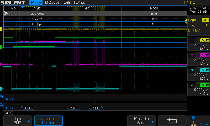

The code is Here, i Think the problem is the initialization of the driver , at the Oscilloscope the SPI Communication seems ok !

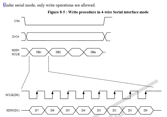

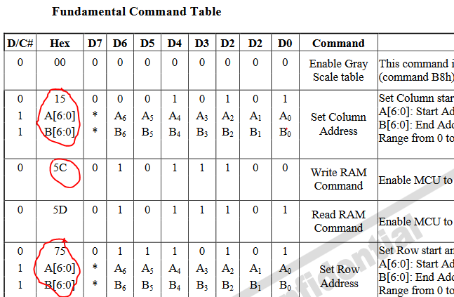

you interpret the commands as bytes.(not as words, tripletes.. and so on)
for example the second initialisation command itself is not a valid command.
each command unity (one or more bytes with params) must be under one cs low pulse.
not send individualy.
You can't keep steady low the cs pin.
CS pin
participate
s in timing and gives the ''trigger for transaction.Also remember that SPI clck must not exceed 10 MHZ

Maybe i understand , yesterday i've redone the program and seeing the same image that have you posted from the datasheet, so i change Chip Select use m( my Nss Pin).
But for ''each command unity'' , what do you mean exactly?
we have Commands and datas, in the new protocol i've designed i put before low and high the chip slect ( NSS) for the command , and another single Nss cycle for all Datas.
Example setting ReMapDualCOMLineMode(CMD 0xB3, Data1 0x14,Data2 0x11)
Nss = 0 SPI Chip Select Enabled
CD = 0 Command
send Command
Nss = 1 Nss Disabled
Nss = 0
CD=1 Data
Send Data 1
Send Data 2
Nss=1

First of all , lets begin with Datasheet we have and how to translate it.
Data transfer pause is never mentioned in this dartasheet. This means that we haven't any knowledge about ''What if pull CS_hi after first byte, in a double or triple byte command? Or what if pull CS_hi in the midle of tranfering a byte?''
or ''Is it mandatory or optional to keep CS at low state between of any kind of sequential or singe writing?.''
or ''In case we omit a single clock pulse (by some reason) , is CS_HI reseting with someway the internal shift register counting circuitry to correct this anomaly, or we need a general reset?''
We dont have theese answers but we have this display working. !
By a ''logic'' way of thinking, and the only fact we have, ( the above ''spi writing diagram'' )
IMHO must divide your data in unities to send to chip. As unity i mean, Under contously CS_LO state,
the one byte command, the two bytes command, the three bytes command, etc and any length of data bytes alone,
just to cover the worst case scennario (not the fastest ) of the above ingnorance.

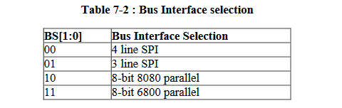

I forgot to mention that BS pins must be grounded in your case.

I used the Midas MCOT128064H1V-GM which is 128 x 64 in a design last year and it works fine in SPI mode. I assume that its controller is either the same or similar. I have never had a chance to get into using HAL drivers and in my driver uses bit-banging instead of an SPI (though I have since got to grips with SPI, the STM32F205 that I used has issues with NSS so fully automatic SPI would not be possible on that STM32F2xx).
Anyway, looking at my code just now, I cycle CS/NSS for each single byte that I send. Sending a command sequence means a CS for every byte in the sequence.
Do you have the data sheet for the controller chip? Midas will send you this if you ask. You should also try emailing Midas with your questions.

Also, it would be a good idea to use another piece of equipment to verify that your SPI transmission is working. For example a logic analyser or scope that has SPI decoding.
