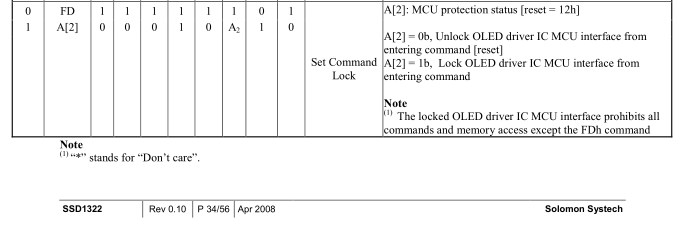

Hi everyone,
ì'm trying to use te OLED MCOT256064BA-WM with the SSD1322 Driver.
Is so frustrating to be in the situation that the code seems really correct at least , but the OLED don't still Work.
I need Help!
i'm using the STM32F412ZGTx, the OLED is a 256x64
The code is Here, i Think the problem is the initialization of the driver , at the Oscilloscope the SPI Communication seems ok !
Thank you very much for every incoming help!!

} void Reset_Device(void) { // Lots of reset/tweaking commands followdisplaySend(SEND_CMD, 0xFD); // Set Command Lock (MCU protection status) ok
displaySend(SEND_CMD, 0xAE); // Sleep On (DisplayOFF) ok, displaySend(SEND_DAT, 0x12); // = Reset Unlocked Oled driver , se Locked accetta solo il Comando FDhdisplaySend(SEND_CMD, 0xB3); // Set Front Clock Divider / Oscillator Frequency
0xFD has one parameter
I haven't checked the rest of your sequence.

2017-08-08 01:55 AM
yes , i've seen the error bur the problem is not solved !!!
displaySend(SEND_DAT, 0x12); // = Reset Unlocked Oled driverdisplaySend(SEND_CMD, 0xAE); // Sleep On (DisplayOFF) ok,
What about the rest?
