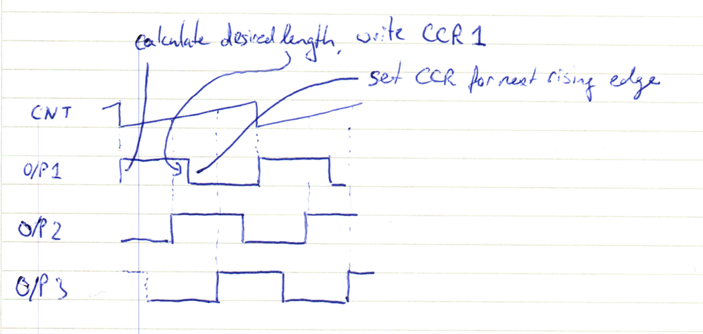

The goal is to calculate how long a pulse needs to be directly after it has started. This is for some control algorithm:
0693W00000GWQSnQAP.pngFor each of the 3 outputs the start is 120 degrees delayed. The length of output is to be controlled individually. Eventually, something similar needs to be done with TIM8, but 60 degrees out of phase with TIM1.

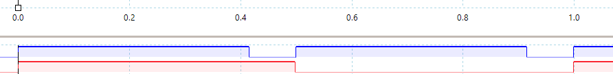

To show you the jitter I am experiencing, I have made a screenshot of the oscilloscope. Output 1 (blue) is programmed as intended, with the rising edge at CNT==00, Output 2 (Red) is set to toggle, every time CNT==0. The generated frequencies are therefor 2 kHz and 1 kHz.
Every rising edge in output 2 aligns perfectly with that of output 1.
0693W00000GWQgpQAH.pngAbove, the trigger is set to the rising edge of output 2. The next rising edge, at 1 ms is showing around 800ns jitter (800PPM).
What is your clock source?
Svan .41
So, I checked the jitter with another piece of SW (with a more normal method of PWM generation). It does look like something is wrong with the clock I'm using (HSI16)
