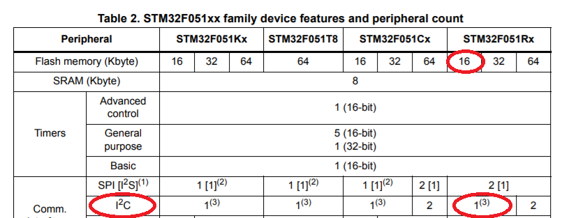

What is the total number of I2C's in STM32F051R4T6TR controller IC.

Hi @Community member​ ,
As indicated in the datasheet, the STM32F051R4T6TR device has one I2C interface: I2C1.

Thanks for the reply,
i actually i found there are two i2cs in STM32F051R4T6TR.I found that I2C1_SCL and I2C1_SDA are in (PB6&PB8) and (PB7&PB9) respectively and I2C2_SCL and I2C2_SDA in (PB10&PF6) and (PB11&PF7) respectively.But the problem is that i could the alternative function table for PORT A and PORT B in datasheet and i have attached the image below.But i couldn't find similar table with the alternative functions of PORT C and PORT F.Without that it would be difficult for us to configure the
GPIOx_AFR register to choose the alternative function corresponding of the pin.Please help me with regards to this issue.

yaa i got it that there is only one I2c in this controller ic.But what does the "1(3)" respresent?
Please have a look on the explanation below the table:
3. I2C2 is not present
