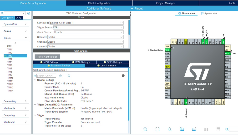

‎2020-01-30 2:40 AM
Hello TH.16.336
You can easly count external pulse by using any GPTimer in Slave Mode clock by using ETR input.
Here an example of CubeMX setup with NucleoF446RE and TIM3.
After generating the code, start the TIM3 with
HAL_TIM_Base_Start(&htim3);
At the end of MX_TIM3_Init() function.
Declare a global volatile variable to read the pulse number (which is the TIM3_CNT value)
/* USER CODE BEGIN PV */
static __IO uint16_t pulseCount = 0;
/* USER CODE END PV */
And read the counter anywhere in your main loop.
/* USER CODE BEGIN WHILE */
while (1)
/* USER CODE END WHILE */
/* USER CODE BEGIN 3 */
pulseCount = __HAL_TIM_GET_COUNTER(&htim3);
/* USER CODE END 3 */

‎2020-01-30 5:18 AM
In other words you want to count the pulses and total only all the 10th pulses.
But you don't need to use the interrupts for this since you are using the configuration I gave you. In this case the TIM3 works alone without the help of the CPU.
Regarding help to validate your solution using a signal generator, here are my tips:
- Connect your generator to PD2 with the desired frequency and amplitude (be careful and check the characteristic of PD2 at maximum voltage in datasheet 3.3 or 5V tolerant)
- From the example I gave you, you should test the pulseCount variable in main loop, each time it has been incremented by 10 pulses. And you increment another variable or else you execute the code you want.
