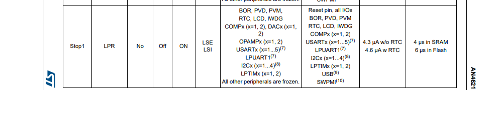

I am using NUCLEO-L4R5ZI-P board, I have measured current consumption by using example project (PWR Mode: STOP1) and I got the following readings :
Practically STOP1 : 1.19 uA
Datasheet STOP1 : 4 uA
Why I am not getting same value mentioned in datasheet is there something wrong?

Hello @Brajp.1​,
When checking the STM32L4R5ZI datasheet, the Current consumption in Stop 1 mode is represented in the following table:
Can you precise which datasheet you are working with and the mode you are using?

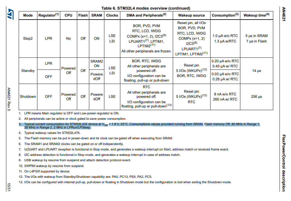

The table of the application note you are referring to concerns the L4 product while you are working with the L4+, please check the note I highlighted in the screenshot below:

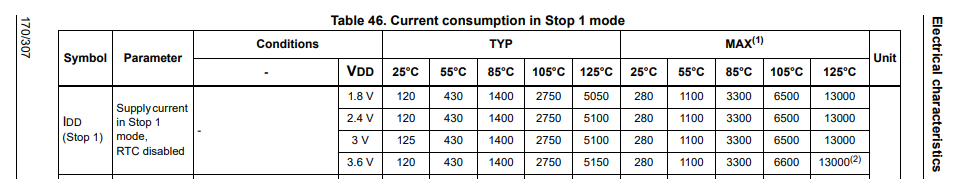

To check the correct values of the power consumption I advise you to refer to the datasheet of STM32L4R5xx since it contains different use cases presented in the table 46.
