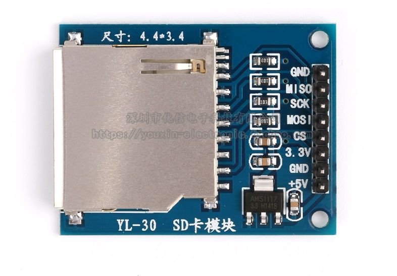

Hi @XZhen.2 (Community Member)​ .
Tomorrow night I'll try to send you a working example with your settings so that you can test if your module works.
I have a module identical to yours and in my case it works without problems

Hi�?I tried another sd card module with the same code, still failed to work.
@GChir.2​
I am looking forward to that because I tried another module, still failed.

@XZhen.2​ Try this simple code (PB6 as cs pin and SP1 enabled).
Make a backup of your sd because, in the code, I inserted the command for formatting the sd card. On my board, with an sd module similar to your, the code works without problems (connect the vcc pin of the sd module to 5V on the board).
Let me know if this solves your problems ;)
@GChir.2​
Hi. thanks for the code.
still failed.
this is the info I got from serial comm.
ERROR in mounting SD CARD...
Total Drive Space: 2147481600 KiB (2047.997 GiB)
Space Available:      0 KiB (0.000 GiB)
ERROR!!! No. 1 in creating file *Test.txt*
ERROR!!! Test.txt does not exists
there might be something wrong with my Nucleo-L476RG board
Could you share a photo with module's connection to the board?
Have you used my code?
There's perhaps something more fundamentally wrong with your implementation or wiring.
The level translators on the prior board will likely become an issue as the bandwidth increases.
With the SDIO/SDMMC implementation I was using uniform wires of around 3"(8 cm), and those were capable of getting me to 25 MHz.
I wouldn't recommend DuPont wires which people seem to use prolifically, but rather something that really bites into the corners of the headers, like Schmartboard jumper wires, or wire-wrap.
https://schmartboard.com/jumper-wires/
Watch the CS to CLK edges, and perhaps back-off on the slew-rates.
