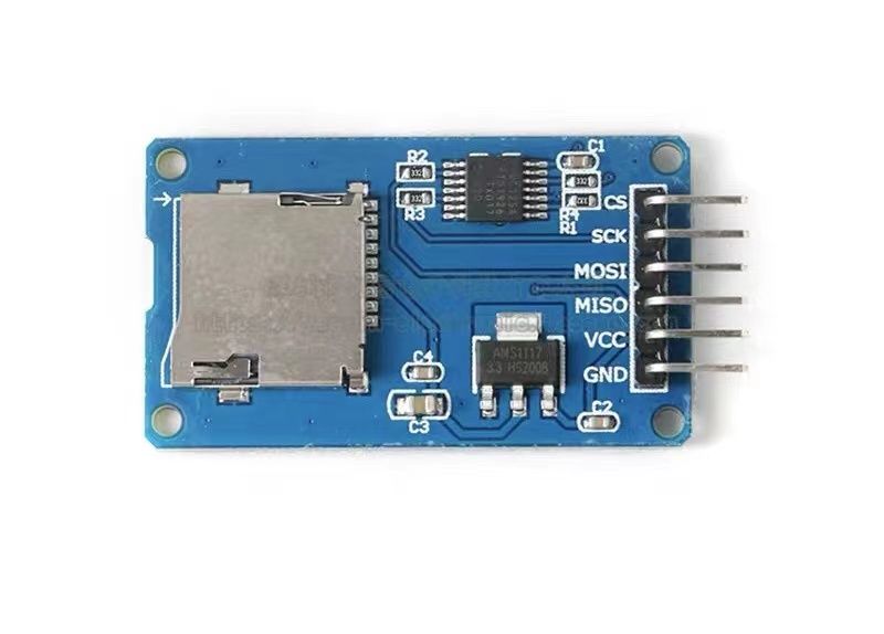

XZhen.2
@GChir.2​ Hi!
I am trying to access SD card using SPI and i think i am using the same FATFS&SPI code that you are using.
but i cant manage to get it work.
have you get your project work?
GChir.2
@XZhen.2​ Hi.
In the archive there is a file called "readme.txt" where I tried to summarize the various steps to use my code. Let me know if everything is clear and if the code works. Sorry for my English but it's not my native language
XZhen.2
@GChir.2​ It's kind of you share your code with me.
I tried your code but still couldn't get it work.
not sure what went wrong.
is there any different setting compare with your code?
BTW, i am using SPI1,and GPIOB,PIN6 as chip select pin
XZhen.2
@GChir.2​
That's a 5V adapter with a level shifter. At the 3.3V of the STM32 you should perhaps consider a more direct connection.
https://www.waveshare.com/micro-sd-storage-board.htm
ok, ordered one just now. I will try again.
thanks!
Hi @XZhen.2​ .
Tomorrow night I'll try to send you a working example with your settings so that you can test if your module works.
I have a module identical to yours and in my case it works without problems
