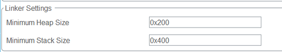

The stack size is the default setting, I have not changed this...
_Min_Heap_Size = 0x200; /* required amount of heap */
_Min_Stack_Size = 0x400; /* required amount of stack */
I have never used stack painting so will need to look further into this.
If the stack size was incorrect, then wouldn't it fail every time ?
The flashing fails the first time but works the next time, it alternatively fails and works.
So why would an incorrect stack size cause this ?

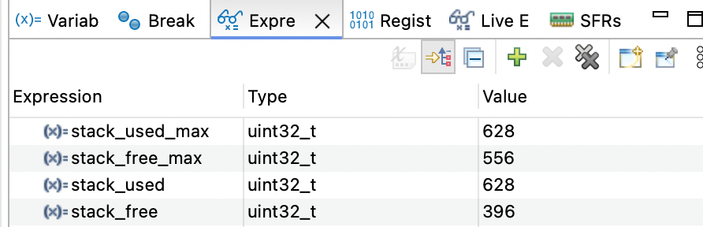

This is driving me crazy, espeically as I am trying to get a custom bootloader to work too.
I checked the stack and its well within the limits....
Below is the code snipet to check the stack...
static uint32_t stack_used;
static uint32_t stack_free;
static uint32_t stack_used_max;
static uint32_t stack_free_max;
int main(void)
  HAL_Init();
  SystemClock_Config();
  Stack_Paint();
void Stack_Paint(void) {
    uint32_t *p = &_stack_end;
    while (p < &_estack) {
        *p++ = 0xA5A5A5A5;  // fill with pattern
uint32_t Stack_GetUsage(void) {
    extern uint32_t _stack_end;
    extern uint32_t _estack;
    while (p < &_estack && *p == 0xA5A5A5A5) {
        p++;
    stack_used = (&_estack - p) * sizeof(uint32_t);  // bytes used
    if (stack_used > stack_used_max)
    	stack_used_max = stack_used;
uint32_t Stack_GetFree(void) {
        p++;
    stack_free = (p - &_stack_end) * sizeof(uint32_t);  // free space in bytes
    if (stack_free > stack_free_max)
    	stack_free_max = stack_used;
Stack_GetUsage and Stack_GetFree is called in a 100ms task and the program is left to run for several minutes.
