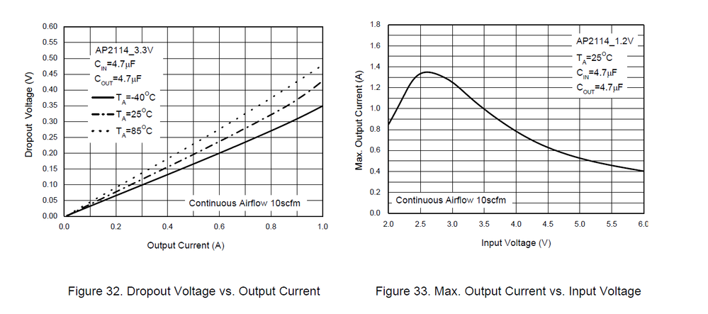

I use this one, AP2114H-3.3TRG1, it is the same PNP type regulator, but will drive upto 1.4A  ( probably only because it can remove the heat easier..)
dropout voltage under 0.2V at 400mA
https://www.digikey.com/product-detail/en/diodes-incorporated/AP2114H-3.3TRG1/AP2114H-3.3TRG1DITR-ND/4470756
