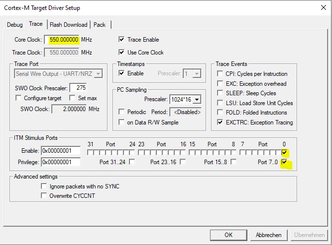

I'm tying to use the ITM printf on my STM32H723 Nucleo board in my Keil project without success. I configured the HAL with CubeMX and add the initialization for the SWD_Init(). I enabled tracing in Keil but I do not get any output.
I checked:
  1. SWO solder bridge SB32 on my board.
  2. The basic clock configuration using a PWM signal.
  3. I also checked SystemCoreClock variable is set to 550 MHz.

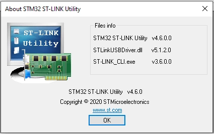

  4. Updated STM Link Utility to newest version

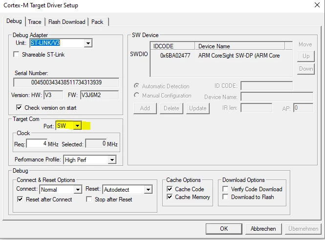

I have no clue why I can't see any output. I will attach my minimal project example as zip and some screenshots of my Keil Debug config. Hope somebody can help me with this. Keil debugger status bar is red and says no "No Synchronization"

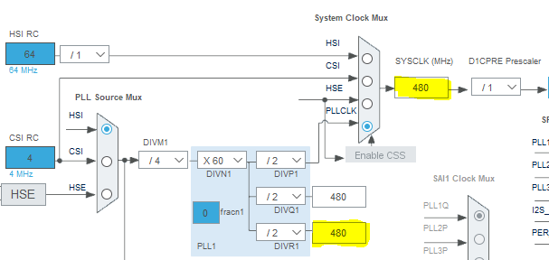

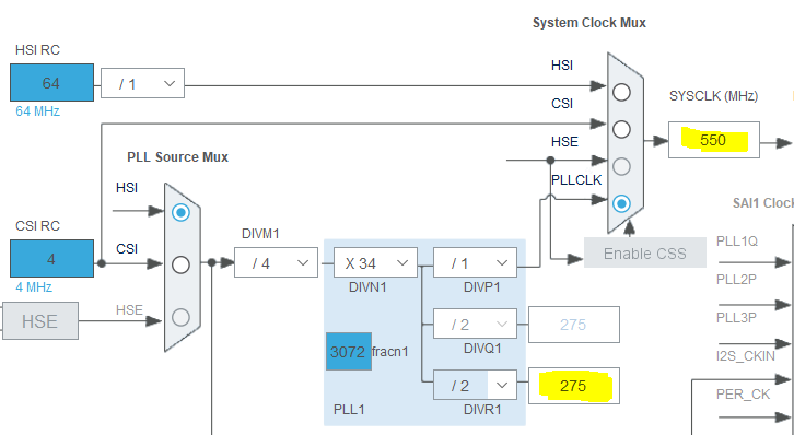

Today I used my oszilloscope to measure the frequency of the SWO signal (Resistor on SB32). I followed the guide https://www.keil.com/appnotes/files/apnt_297_v102.pdf on page 4. I discovered that the signal was running at 1MHz not at 2MHz as expected. I seams that the SWO interface runs with half core frequency. I adapted the SWD Init and now it works as expected.
Edit:
The reference manual says:
0693W000008wRCqQAM.pngSo now I wanted to know where the trace clock is defined in the clock tree.
First I found this on the segger homepage:
https://www.segger.com/products/debug-probes/j-trace/technology/setting-up-trace/
"The trace clock speed (TRACECLK) is on most microcontrollers directly dependent on the CPU clock speed and is usually half of the CPU clock speed."
Then I discovered this in the STM32H723 reference manual page 3088
0693W000008wUAOQA2.pngThen I looked into the clock tree in CubeMX and discovered:
Then I compared the result with the STM32H743 clock tree of my other project:
So now I understand why my code modification is working. Maybe it is better to modify the SWD_Init code to use the DIVR1 value instead of the magic divider 2.

I agree but that wasn't the problem here. I configured Keil for 2MHz clock and did the same in my inital SWD_Init(). But I measured 1MHz instead of 2MHz. Then I adapted the prescaler in SWD_Init() by half and everythink worked. Now I'm wondering why.
