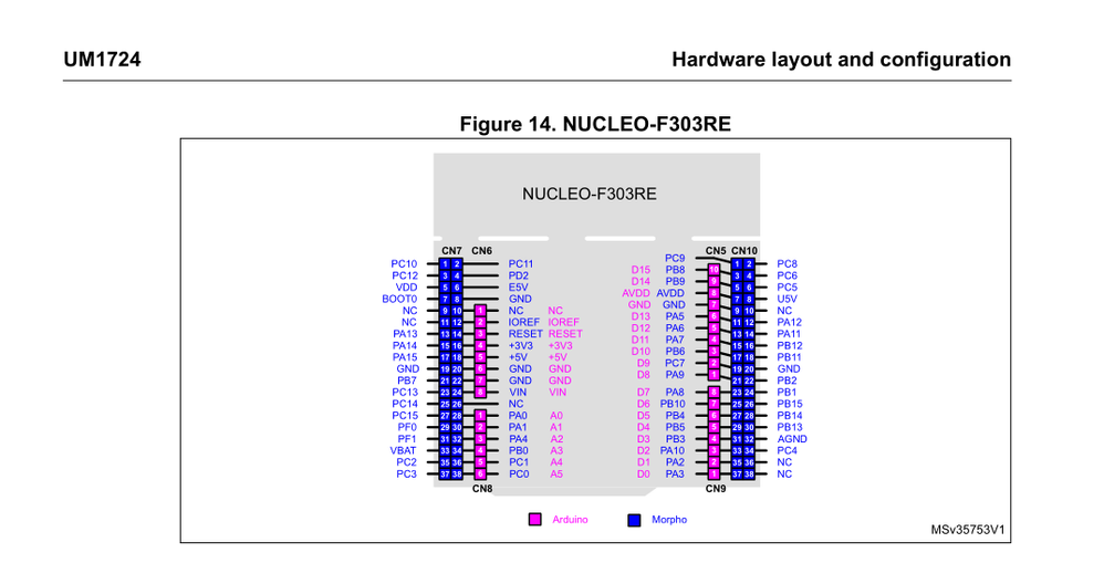

Where can I find the alternate function mapping for GPIO pins?
Normally these can be found in User Manual for a given card, but I can't find it for the NUCLEO-F303RE.

You need to do it in two steps: first, in Nucleo's UM, you find the connector-to-pin mapping:
and then in the 'F303RE datasheet look up the pin-to-alternate function table.

‎2018-01-17 7:42 AM
Data Sheet for the CHIP not the manual for the BOARD

My usual approach is to first get the device UM
pin-to-alternate function table into Excel, then the board
connector-to-pin mapping into Excel, the use Excel's VLOOKUP (table look-up) feature to join the two together.

Start the CubeMX, select for example PA10 as usart and press Ctr and left mouse botton - you will see alternate pin - PB7 in this case
