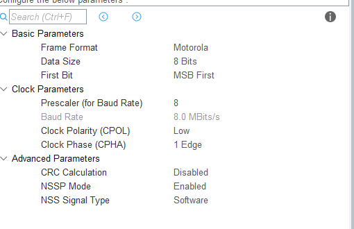

I'm always getting spiRxBuf as '255', whereas I need to read it as 0x55(which is What I had written in the first step).
I have tried for so long but still not able to establish proper communication. Attached my IOC file for you to know about the configurations of my SPI too.
Mysytem clock frequency = 64Mhz;
Prescaler for SPI = 8;
SPI_SPEED = 64/8 = 8Mhz(Suggested SPI_SPEED for OV5642 module in datasheet)
Calculation for SPI SPEED
