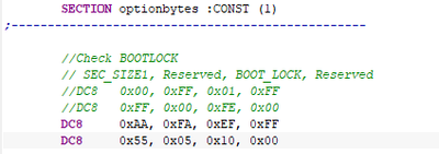

I am using STM32G431 MCU and PB8-BOOT0 pin is used as UART3 RX, with STM32 cube programmer i am able to change option bytes, but for my production, i need single hex file included with option bytes,
I tried with below method
In .s File added below lines to
	SECTION optionbytes :CONST (1)
        //Check BOOTLOCK
        // SEC_SIZE1, Reserved, BOOT_LOCK, Reserved
        DC8	0x80, 0xFF, 0xFF, 0xFF
        DC8	0x7F, 0x00, 0x00, 0x00
        END
In .icf file added below lines
define symbol OPTSTART  = 0x1FFF7828;
define symbol OPTEND    = 0x1FFF782F;
place at address mem: OPTSTART { ro section optionbytes};
BOOT_LOCK option bytes values are appended in hex file as below in 0x1FFF7828 location
But I am seeing no change in option bytes, tried with other option bytes like BOR level, i am seeing the change for BOR, why BOOT_LOCK is not changing.

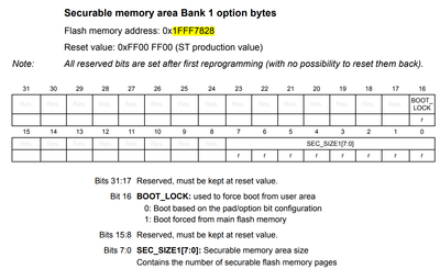

The 0x7F000000 value you're putting in doesn't match the table you've provided or what's in the reference manual. If you want BOOT_LOCK=1, and SEC_SIZE1=0, then you should write 0xFF01FF00 for the 32-bit option byte or 0x00FE00FFFF01FF00 for the 64-bit register.

In my question, value is 0xFFFFFF80, were BOOT_LOCK is 1 and SECSIZE1 is 0x80
for 64 bit value is 0x0000007FFFFFFF80,

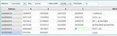

Anyway, i tried as you suggested and below is the stm32 cube programmer snapshot
but no luck, am i missing something..?
