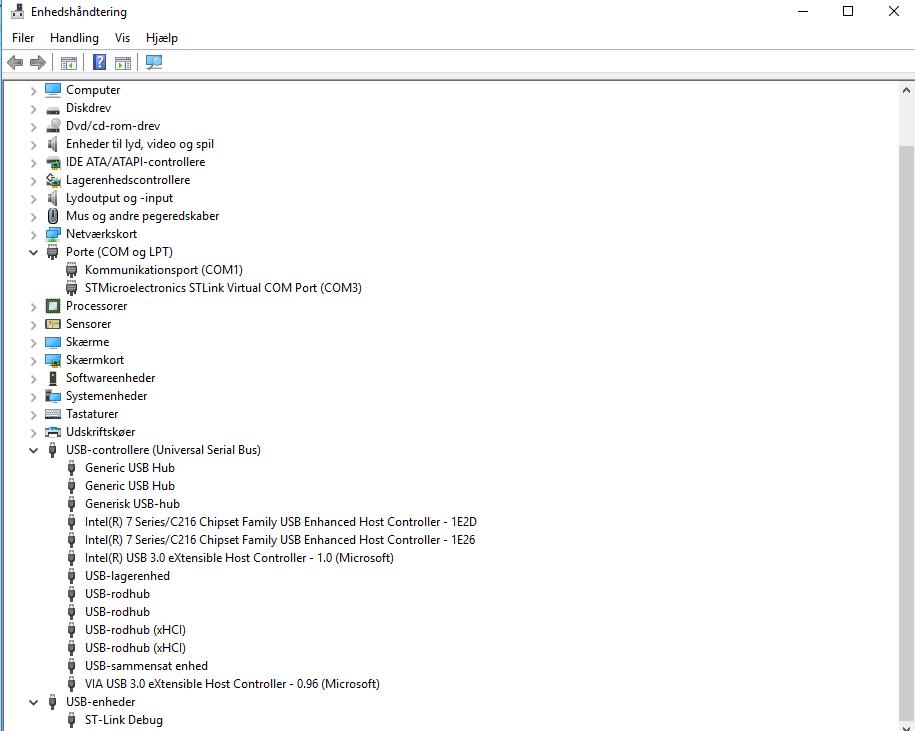

I have already tried to update the drivers multiple times without any luck. Here is a picture of my device manager, which does not seem to contain the ''STMicroelectronics STLink dongle'':

ok kristian
the board you are using is including a STLink dongle the small part where you usb plug is (witch I call also probe sorry it's a direct translation of french word and may be not accurate) you can use it also for flash other boards but here it looks binded to the nucelo as describe here
anyway i think it's well known by windows under 'st link debug'
I sugest you to upgrade your probe (I checked it's the right word ) firmware by using this
(requiring a power off/on of your probe)and check your board documentation about the 2 jumpers on the right side of usb plug

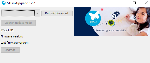

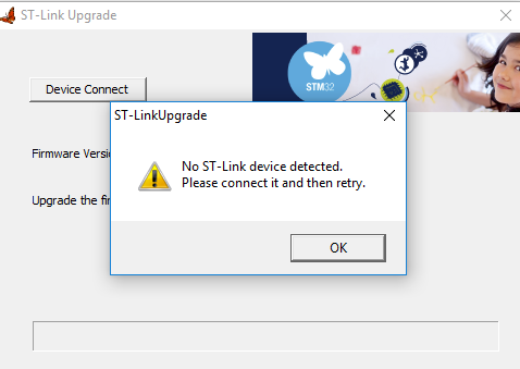

I am still having problems with the connection, and I still get the error message ''no st-link detected'' when i try to connect. I tried to upgrade my probe using the software that you linked, but that unfortunately had no effect. I tried both versions included, but got the following:
And with the other one, I simply get no device that I can choose, as seen here:
And there are no options in the dropdown menu.
