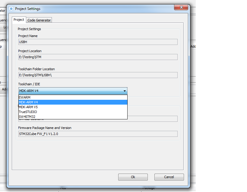

i am using stm32f105 microcontroller for usb application. i installed stm32cube. and configured but at the end i m confused to select toolchain. Which toolchain is to select.
I am using eclipse, so from this dropdown box which toolchain is to selct.

Well none of them are exactly what you want, the last two are at least GNU based. Failing that install a tool-chain that's actually supported directly if you want them to integrate properly.

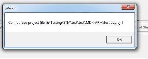

Ok. for this i used Keil uvision 4. But after creating project it generate files and if i tried to browse the code i got following error screen.0690X00000604t4QAA.png

1-First of all, System Workbench for STM32  is an Eclipse integrated IDE. So, you can use it.
2-Concerning the error generated by keil, try to install the last version MDK Version 5.

Thanks it works with uvision 5. But i can use uvision 4 only.
And after creating files, is there any changes required in files?
